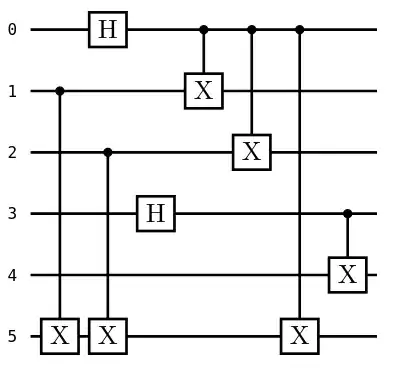

  1. First construct an encoding circuit for the code. Here, the two inputs are at qubits 1 and 2 and the others are ancilla. Call this circuit $E$. encoding circuit

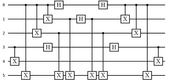

  2. To construct a unoptimized non-transversal $H$ gate for the first logical qubit, we do the following. First, we run $E$ in reverse to decode the state, then apply $H$ to qubit 1, then apply $E$ again. This yields the circuit, non-simplified H_0

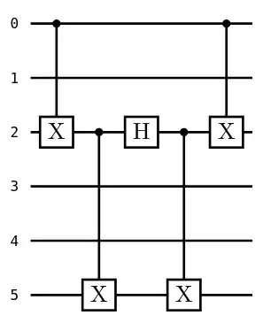

  3. Next note that most gates in this circuit can be cancelled, leaving behind simplified H_0
This is our $\bar{H}_0$.

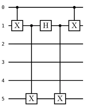

Following the same process for $\bar{H}_1$, where we do in order reverse(E), $H_2$ and $E$, we obtain after simplification
simplified H_1
