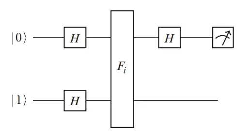

Another simple illustrative example is the Deutsch algorithm: you have two types of functions: constant (either 0, or 1) or balanced (half the values are 0, and half are 1). There are such four functions given and you don't know which is which. Now pick a function at random and tell whether it is balanced or constant. I won't go into too much detail about the whole algorithm, but I just want to show what the oracle does. The quantum circuit for this problem is the following: quantum circuit

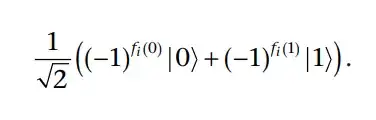

The state of the top qubit after passing through the oracle is this: enter image description here
After passing through the oracle, it gets through a Hadamard gate. It should be clear that after this, you can tell if your function is constant or balanced, because a Hadamard gate sends $ \ | + \rangle $ to $ \ | 0 \rangle $ and $ \ | - \rangle $ to $ \ | 1 \rangle $. So, depending on whether you get 0 or 1 after measuring, you get the exponents of -1 from above and therefore the function type.
