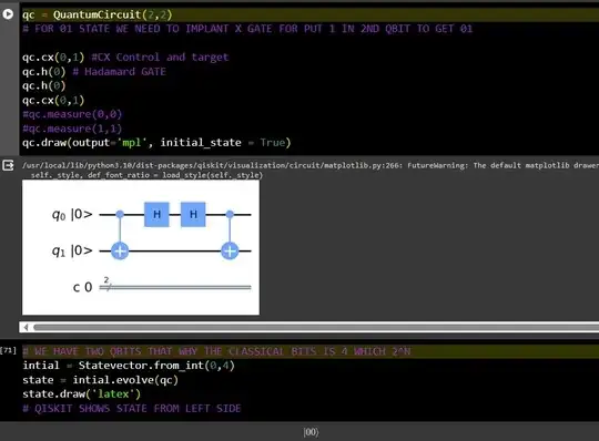

You have to apply reverse U^ gate for vail the results. CNOT then Hadamard gate. description are given below
See the latest Inverse Unitary gates to denote the input of bipartite qubits where Bell state was formed
