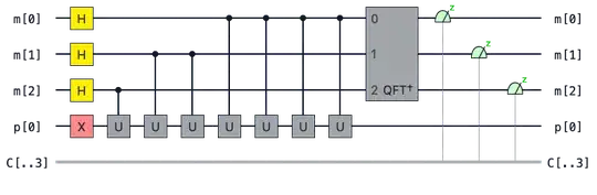

A pytket circuit diagram of a trivial instance of QPE is shown below where I estimate the phase applied by a single qubit rotation gate. This is similar to a pedagogical example given in the qiskit textbook.
Quantum phase estimation diagram Here the $U$ is defined as follows

In this case its super easy to just use the Pauli $X$ gate to prepare the $|1 \rangle$ eigenstate of $U$.
$$ \begin{equation} U(\varphi)|1\rangle = e^{i \varphi}|1\rangle \, . \end{equation} $$

Your supposition is spot on. Indeed, quantum phase estimation (QPE) can be applied even when the input state is not an eigenstate of the unitary $U$. The key point to note is that, by expanding the input state in the eigenbasis of $U$, the coefficients of such linear combination will remain unaffected by the controlled powers of $U$ as they do not mix eigenstates. As a result, given an input state $\sum_{i} c_i |\phi_i\rangle$, where $\{ |\phi_i \rangle \}$ is the eigenbasis of $U$, then the phase associated with eigenstate $|\phi_i \rangle$ is measured in the ancillary register with probability $\sim |c_i|^2$, in which case the main register is projected onto the corresponding eigenstate. This point is already noted in Nielsen & Chuang ($10^{\textrm{th}}$ anniversary edition, Exercise 5.8). Another reference that might be worth having a look at is this paper by O'Brien, Tarasinski and Terhal.
Starting from a linear combination of eigenstates is, in fact, the most relevant use of QPE, as far as applications are concerned. In particular, we foresee using QPE to find the ground state of quantum many-body systems by starting from an input state that has a non-negligible overlap with such exact ground state. By "non-negligible" we mean that the inverse of the overlap scales polynomially with the system size, otherwise the average number of repetitions will not be feasible for a sufficiently large system.
As you alluded to in your question, preparing such an input state is quite a challenge. Assuming we have no circuit depth constraints (i.e., that we have fully fault-tolerant quantum hardware at our disposal), the natural approach is to prepare such state adiabatically, although care must be taken with the choice of adiabatic path in order to avoid closing the spectral gap, in which case the adiabatic theorem breaks down. With noisy intermediate-scale quantum hardware, we have to be even more ingenious, exploiting physical insights about the specific problem we are tackling to find an easy-to-prepare input state that is close enough to the exact ground state.
