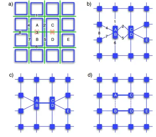

For the toric code, it's relatively easy to see how many erasure errors can be corrected. You can understand this by looking at how one can correct erasure errors. In the following figure a) (from https://arxiv.org/abs/0904.3556) erasure errors happen to data qubits indicated by the 2 red crosses.
As shown in b) one erasure error can be overcome by 'merging' two weight 4 stabilizers to form a weight 6 stabilizer. In the example shown in the figure, four weight 4 stabilizers are merged to form two weight 6 stabilizers.
A logical operator on the toric code is any cycle going around the torus (donut). Therefore the logical operator can be measured if there is at least one cycle that avoids all deleted qubits.
If you delete all qubits that form a cycle, you can't measure the logical operator anymore. The smallest cycle one can form consists of $d$ data qubits, and therefore we can correct upto $d-1$ erasure errors in the toric code.
