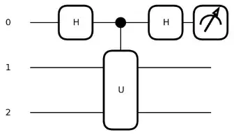

Given the 2-qubits Hamiltonian $\hat{H}$, this is how you can perform the Hadamard test in Pennylane:
import pennylane as qml
dev = qml.device('default.qubit', wires=3)
@qml.qnode(dev) def hadamard_test(U): qml.Hadamard(0) qml.ControlledQubitUnitary(U.matrix(), control_wires=[0], wires=[1,2]) qml.Hadamard(0) return qml.expval(qml.PauliZ(0))
ham = qml.PauliX(0) @ qml.PauliZ(1) res = hadamard_test(U=ham) qml.draw_mpl(hadamard_test)(U=ham)
More in general, you can transform any unitary matrix $U$ in a multi-controlled gate by using ControlledQubitUnitary.
