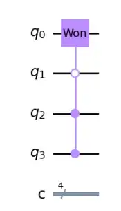

I am qurious about the order of ctrl_state
The Quantum Circuit what I expected is this.
q1 is controled when '0' and q2 and a3 is controled when '1'
So I wirte code that is
ctrl_state='011'
But what I got is this. Why I got oposite form like this... What is the principle of this.

This is because Qiskit uses little-endian bit ordering. That means, in your case ctrl_state should be $q_3 q_2 q_1$.
You can find more details here and here.
