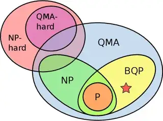

"What about solving NP-complete problems like SAT? Anything else?"
This diagram (from here) shows that the QMA complexity class does possibly have some overlap with the class of NP-hard problems, but is not expected to be able to cover all NP-hard problems:
Therefore, some NP-hard problems may be even too difficult for a perfectly operational quantum computer to solve efficiently!
