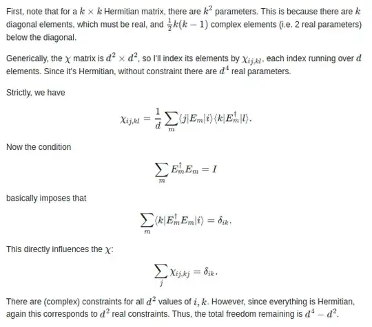

A post, Why does the $\chi$ matrix have $d^4-d^2$ independent parameters?, has been asked on this, which contains an answer by @DaftWullie, which make use of the Choi matrix,
post
where it seems like $\chi$ is used to represent the Choi matrix, not the $\chi$ matrix.

This directly influences the $\chi$: $$ \sum_j\chi_{ij,kj}=\delta_{ik} $$ There are (complex) constraints for all $d^2$ values of $i,k$. However, since everything is Hermitian, again this corresponds to $d^2$ real constraints. Thus, the total freedom remaining is $d^4-d^2$.
How do we obtain $\sum_j\chi_{ij,kj}=\delta_{ik}$ ?
How does imposing the trace-preserving condition $\sum_m E_m^\dagger E_m=I$ on the Choi matrix obtains the number of constraints on the $\chi$ matrix ?

Applying the trace preserving condition, $\sum_m E_m^\dagger E_m=I\implies\sum_m \langle k|E_m^\dagger E_m|i\rangle=\delta_{ik}$, how do we reach\begin{align} \sum_j\chi_{ij,kj}&=\delta_{ik} \end{align}

Counting the number of free parameters of Choi operators
The number of independent parameters in the $\chi$ matrix is identical to the number of independent parameters in the Choi matrix, or in the channel itself, because these are all isomorphic representations of the same objects.
A map $\Phi$ acting on (the set of linear operators defined on) a Hilbert $H$ is a channel (meaning, it's completely positive and trace-preserving) iff its Choi representations, defined as $J(\Phi)\equiv\sum_{ij}\Phi(|i\rangle\!\langle j|)\otimes|i\rangle\!\langle j|$, is positive semidefinite and such that $\operatorname{tr}_1(J(\Phi))=I$.
The set of Hermitian operators on a Hilbert space $H$ is a vector space of (real) dimension $\operatorname{dim}(H)^2$. The set of positive semidefinite operators on a Hilbert space $H$ is a (compact, convex) subset of this space, and thus has the same number of independent parameters.
The set of Choi operators $J(\Phi)$ of channels $\Phi$ is a subset of the set of positive semidefinite operators on $H\otimes H$. It thus has $\dim(H\otimes H)^2=\dim(H)^4$ independent real parameters. However, the trace-preserving condition removes some of these degrees of freedom. The trace-preserving condition, which reads $\operatorname{tr}_1(J(\Phi))=I$, amounts explicitly to the $\dim(H)^2$ conditions: $$\sum_i J(\Phi)_{ij,ik}=\delta_{jk}, \qquad \forall j,k=1,...,\dim(H). $$ You can verify that these conditions are linearly independent, and thus remove $\dim(H)^2$ free parameters. You conclude that the set of Choi operators is a subset of $\operatorname{Lin}(H\otimes H)$ with $\dim(H)^4-\dim(H)^2$ free parameters.
Reason directly from the $\chi$ representation
You can also just reason directly in terms of the $\chi$ matrix, because $\chi$ and Choi are related via $\chi_{mn}=\langle \tilde E_m|J(\Phi)|\tilde E_n\rangle$, $J(\Phi)=\sum_{mn} \chi_{mn} |\tilde E_m\rangle\!\langle \tilde E_n|$ for some choice of orthonormal operatorial basis $\{\tilde E_m\}$.
I think it's worth showing where some of the relations given in this answer come from though, because the notation can be tricky here. Namely, what exactly the kets and bras in $J(\Phi)=\sum_{mn} \chi_{mn} |\tilde E_m\rangle\!\langle \tilde E_n|$ mean.
I'll somewhat follow the notation in the linked answer, so that the relation between channel/map $\Phi$ and its Choi representation reads $$\Phi(\rho) = \sum_{m,n} \chi_{m,n} P_m \rho P_n^\dagger.$$ Each $P_m$ is here an operator acting on $H$, and $\{P_m\}$ is a basis for the space of such operators. The Choi representation derived from this decomposition is $$J(\Phi) = \sum_{ij} \Phi(E_{ij})\otimes E_{ij} \equiv \sum \chi_{m,n} (P_m E_{ij} P_n^\dagger)\otimes E_{ij}.$$ Consider the action of $J(\Phi)$ on some simple vector $|\alpha\rangle\otimes|\beta\rangle$, which gives $$J(\Phi)(|\alpha\rangle\otimes|\beta\rangle)= \sum_{m,n,i} \chi_{m,n} (P_m E_{i,\beta} P_n^\dagger |\alpha\rangle)\otimes |i\rangle \\ = \sum \chi_{m,n} (P_n^\dagger)_{\beta,\alpha} (P_m |i\rangle)\otimes |i\rangle = \sum \chi_{m,n} (\bar P_n)_{\alpha\beta} (P_m)_{ji} (|j\rangle\otimes |i\rangle).$$ In other words, the action of $J(\Phi)$ on a generic vector $v\in H\otimes H$ can be written as $$J(\Phi)v=\sum_{m,n} \chi_{m,n}\langle \operatorname{vec}(P_n), v \rangle \operatorname{vec}(P_m),$$ where $\operatorname{vec}(P)$ denotes the vectorisation of an operator $P$. Explicitly, if $P:H\to H$, then $\operatorname{vec}(P)\in H\otimes H$ with $\operatorname{vec}(P)_{ij}=P_{ij}$.
The above relation is what we mean when writing $J(\Phi)$ as a sum over ket-bras of a basis of operators. So, armed with this knowledge, how do we compute $\operatorname{tr}_1(J(\Phi))$ from the expression with the $\chi$ matrix, which is what we want to do to derive what trace-preserving translates into for $\chi$? At the cost of being pedantic, we can start observing that $\operatorname{tr}_1(J(\Phi))$ means explicitly $$\operatorname{tr}_1(J(\Phi)) = \sum_{\alpha} (\langle\alpha|\otimes I)J(\Phi)(|\alpha\rangle\otimes I) \equiv \sum_{\alpha\beta\gamma} (\langle\alpha|\otimes\langle\gamma|)J(\Phi)(|\alpha\rangle\otimes|\beta\rangle) \, |\gamma\rangle\!\langle \beta|,$$ and using the expression for $J(\Phi)$ in terms of $\chi_{m,n}$ we get $$(\langle\alpha|\otimes\langle\gamma|)J(\Phi)(|\alpha\rangle\otimes|\beta\rangle) = \sum_{m n\alpha\beta\gamma} \chi_{m,n} (\bar P_n)_{\alpha,\beta} (P_m)_{\alpha,\gamma},$$ and therefore $$\operatorname{tr}_1(J(\Phi)) = \sum \chi_{m,n} P_n^\dagger P_m,$$ hence the trace-preserving condition becoming $\sum_{m,n} \chi_{m,n} P_n^\dagger P_m = I$.
