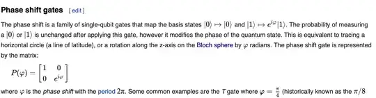

This is the specific gate I want to implement using pytket: corresponding Wikipedia page
Wikipedia entry of Phase shift gate

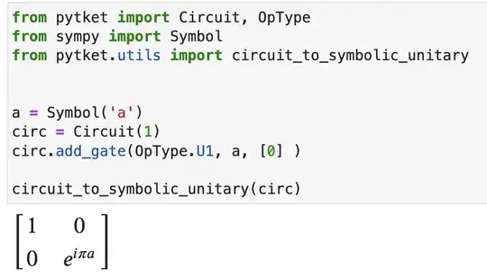

I see that you did figure out that pytket supports the U1(angle) gate which is another name for the P(angle) gate.
To add this gate you need the OpType enum. This is sometimes the case with less common gates. pytket OpType enum
from pytket import Circuit, OpType
from sympy import Symbol
from pytket.utils import circuit_to_symbolic_unitary
angle = Symbol('a') circ = Circuit(1) circ.add_gate(OpType.U1, angle, [0])
circuit_to_symbolic_unitary(circ)
screen shot of code
