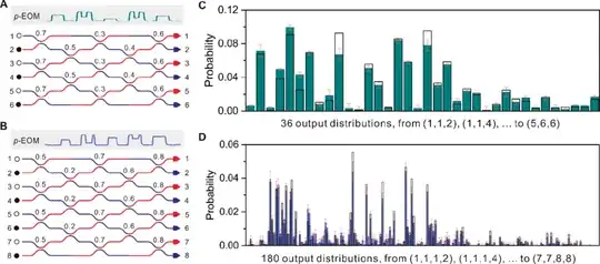

Boson sampling is a computation that is not doable on classical machines but quite doable on quantum photonic machines.
(https://www.researchgate.net/figure/Experimental-results-for-3-and-4-boson-sampling-A-B-The-equivalent-3-and-4-boson_fig2_301872712)
The precise generated pattern at the end of the board will take impossibly long to compute/simulate on classical machines.
However, just being a computation that is not doable by classical machines does not seem too rare or special... Classical computers cannot fully simulate the brain of a six-year-old for even a microsecond either.
So are there any practical uses for being able to perform boson sampling, other than doing a computation that classical machines cannot do?
