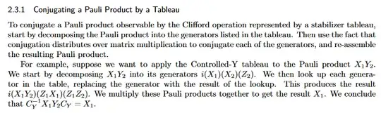

In short, any element $W(z,x)$ of the Pauli group is specified by a binary string $a=(z,x) \in \mathbb{F}_2^{2n}$, where the $z$ and $x$ part indicates whether there is an $Z$ or $X$ operator (or both,i.e. $Y$) on the $i$-th qubit. Cliffords then act as $$ U W(a) U^\dagger = \pm W(g(a)), $$ where $g\in \mathbb{F}_2^{2n\times 2n}$ is a binary matrix. In fact, $g$ is a symplectic matrix (see my other answer), but that doesn't matter here. The point is that you only have to compute the matrix-vector product $g(a_i)$ for any generator $a_i$ of a stabilizer group, which in total makes $n \times n^2 = n^3$ operations.

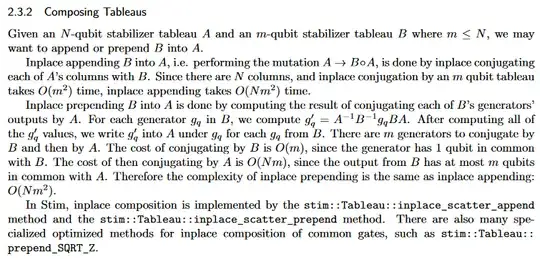

Applying an arbitrary $n$-qubit Clifford operation, represented as a stabilizer tableau, to an arbitrary $n$-qubit stabilizer state, also represented as a stabilizer tableau (or equivalently as a list of stabilizer generators), can be done in $O(\text{matmul}(n))$ time. It's just $n \times n$ matrix multiplication with a few extra steps.
As far as I know, no software for simulating Clifford stuff actually does fancy matrix multiplications. It all just does schoolbook matrix multiplication, which is $O(n^3)$ time. For example, that's what Stim does:
And you can even try it:
