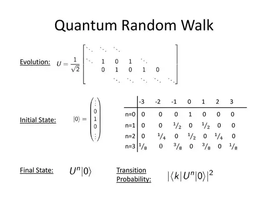

Quantum Walk may not perform in optimal ways over a conventional and determinisitc binary tree data structure. In a quantum walk experimental setup, the coin will not follow a binomial distribution. Construction of a quantum superposition based index for a tree data structure would be a better model. In one of the most popular implementations, a quantum walk involves a coin flip followed by a bit shift operator. The quantum walk involves a rotation of the coin space followed by the conditional shift operator. The quantum walk begins to differ from the classical walk from the initial epochs onwards. This asymmetry arises because the Hadamard coin treats the two directions |left⟩ and |right⟩ differently.
The quantum walk propagates quadratically faster than the classical walk. the quantum walk spreads faster, at a rate proportional to the number of steps, instead of the square root of the number of steps as in the classical case, a quadratic speed up. An interesting addition to this model is to consider quantum logical states for the coin flipping experiment. The solution is to make the coin quantum too, and give it a unitary twist instead of a random toss. The quantum coin keeps track of which way you arrived at your location, allowing you to retrace your steps.
