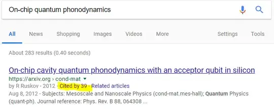

Yes other papers have studied phononic qubits after that one. I could just list them here, but I think it would be better for you to learn how to find such papers yourself, so here is how I found the papers:
Find the paper on Google, then click the link I have highlighted in yellow:
Out of the 39 papers that cited this one, I have listed some (but not all) of the relevant ones below:
