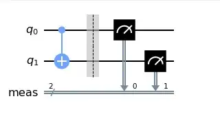

For the following code
qc = QuantumCircuit(2)
qc.cx(0,1)
qc.measure_all()
qc.draw()
Q1: What this vertical dotted line represent in the below circuit diagram?
Q2: 'meas' wire in the circuit is what kind of wire? is this classical wire or qubit wire?
Q3: How qc.measure_all() is different from qc.measure([0,1],[0,1])[couldn't find a simple answer on internet]
Circuit Diagram

  1. the vertical line is a barrier
  2. meas are classical bits , it will have the output of the measure_all function
  3. measure_all adds new bits to the circuit ,you don't have to define them, when you use measure you have to first define the classical bits. The 2 examples here show that , in the first one 2 qubits and 2 classical bits are defined , while in the second one 5 qubits are defined from qiskit import QuantumCircuit qc = QuantumCircuit(2, 2) qc.h(0) qc.cx(0, 1) qc.measure([0, 1], [0, 1]) qc.draw() from qiskit import QuantumCircuit qc = QuantumCircuit(5) qc.h(0) qc.cx(0, range(1, 5)) qc.measure_all()

Re Q1:
Be careful with vertical dotted line being treated only as visual logical separation of circuits. It looks like it may be interpreted by transpilers:
https://medium.com/arnaldo-gunzi-quantum/what-is-the-barrier-in-qiskit-for-7d1547bebd1
Reference:
https://quantum-computing.ibm.com/composer/docs/iqx/operations_glossary
Barrier operation
To make your quantum program more efficient, the compiler will try to combine gates. The barrier is an instruction to the compiler to prevent these combinations being made. Additionally, it is useful for visualizations.
Here is more information about barrier operation in another already answered questions:
  1. What is a "barrier" in Qiskit circuits?
  2. Is there a physical definition of barrier operation in qiskit?
