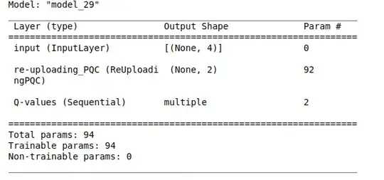

the topology:
It could be great if this library let us specify the dqn_target instead of doing Clone. Because working with hybrid neural networks with a cirquit with parameters in a layer, it's difficult to serialize it. So, when it runs the line: model.get_config(), it fails.
