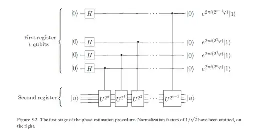

Here's the circuit diagram for the Phase estimation algorithm:
The first register having $t$ qubits is supposedly the "control register". If any of the qubit in the first register is in state $|1\rangle$ the corresponding controlled unitary gate gets applied to the second register. If it is in a state $|0\rangle$ then it doesn't get applied to the second register. If it is in a superposition of the two states $|0\rangle$ and $|1\rangle$ the action of the corresponding unitary on the second register can be determined by "linearity". Notice, that all the gates are acting only on the second register and none on the first register. The first register is supposed to be only a control.
However, they show that the final state of the first register as:
$$\frac{1}{2^{t/2}}\left(|0\rangle+\text{exp}(2\pi i 2^{t-1}\varphi)|1\rangle)(|0\rangle+\text{exp}(2\pi i 2^{t-2}\varphi)|1\rangle)...(|0\rangle+\text{exp}(2\pi i 2^{0}\varphi)|1\rangle\right)$$
I'm surprised as to why we consider there to be a change in the state of the first register of qubits at all, after the action of the Hadamard gates. The final state of the first register should just have been
$$\left(\frac{|0\rangle+|1\rangle}{\sqrt 2}\right)^{\otimes t}$$
isn't it? I say this because the first register is supposed to be a control only. I don't understand how or why the state of the first register should change when acting as a control.
I initially thought that considering the exponential factors to be part of the first register qubit states was only a mathematical convenience, but then it didn't make sense. State of a qubit or a system of qubits shouldn't depend upon what is mathematically convenient to us!
So, could someone please explain why exactly the state of the first register of qubits changes, even when it simply acts as a "control" for the second register? Is it just a mathematical convenience or is there something deeper?

This same phenomenon of 'control' qubits changing states in some circumstances also occurs with controlled-NOT gates; in fact, this is the entire basis of eigenvalue estimation. So not only is it possible, it is an important fact about quantum computation that it is possible. It even has a name: a "phase kick", in which the control qubits (or more generally, a control register) incurs relative phases as a result of acting through some operation on some target register.$\def\ket#1{\lvert#1\rangle}$
The reason why this happens
Why should this be the case? Basically it comes down to the fact that the standard basis is not actually as important as we sometimes describe it as being.
Short version. Only the standard basis states on the control qubits are unaffected. If the control qubit is in a state which is not a standard basis state, it can in principle be changed.

The same thing which I have sketched for the effect of CNOT on X-eigenbasis states, is also going on in phase estimation, only with a different transformation than CNOT. The 'phase' stored in the 'target' qubit is kicked up to the 'control' qubit, because the target is in an eigenstate of an operation which is being coherently controlled by the first qubit. On the computer science side of quantum computation, it is one of the most celebrated phenomena in the field. It forces us to confront the fact that the standard basis is only special in that it is the one we prefer to describe our data with — but not in how the physics itself behaves.

Imagine you have an eigenvector $|u\rangle$ of $U$. If you have a state such as $|1\rangle|u\rangle$ and you apply controlled-$U$ to it, you get out $e^{i\phi}|1\rangle|u\rangle$. The phase isn't attached to a specific register, it's just an overall multiplicative factor.
Now let's use a superposition on the first register: $$ (|0\rangle+|1\rangle)|u\rangle\mapsto |0\rangle|u\rangle+e^{i\phi}|1\rangle|u\rangle $$ You can rewrite this as $$ (|0\rangle+e^{i\phi}|1\rangle)|u\rangle $$ so it appears on the first register, even though it was sort-of created on the second register. (Of course that interpretation isn't entirely true because it was created by a two-qubit gate acting on both qubits).
This step is at the heart of many quantum algorithms.
Why don't we write $|\Psi\rangle=|0\rangle|u\rangle+|1\rangle(e^{i\phi}|u\rangle)$ and just claim that it is not separable?
One can't just claim it, but must show it mathematically. For example, we can take the partial trace over the second qubit, $$ \text{Tr}_B(|\Psi\rangle\langle\Psi|_{AB})=\text{Tr}_B(|0\rangle\langle 0|\otimes |u\rangle\langle u|+|1\rangle\langle 0|\otimes e^{i\phi}|u\rangle\langle u|+|0\rangle\langle 1|\otimes |u\rangle\langle u|e^{-i\phi}+|1\rangle\langle 1|\otimes e^{i\phi}|u\rangle\langle u|e^{-i\phi}) $$ To take the partial trace, we pick a basis to sum over. For simplicity, let's pick $\{|u\rangle,|u^\perp\rangle\}$ where $\langle u|u^\perp\rangle=0$ and $\langle u|(e^{i\phi}|u\rangle=e^{i\phi}$. Then you get $$ \text{Tr}_B(|\Psi\rangle\langle\Psi|_{AB})=|0\rangle\langle 0|+e^{i\phi}|1\rangle\langle 1|+e^{-i\phi}|0\rangle\langle 1|+|1\rangle\langle 1| $$ This is rank 1 (and you can see the phase has appeared on the first register), so the state is not entangled. It is separable.
