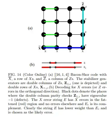

Larger Bacon-Shor codes work similarly. For an $n\times n$ lattice of qubits, there are a bunch of 2-qubit gauge operators, arranged like "dominoes" on the lattice. The $X$ type gauge operators are horizontal dominoes, and the $Z$ type gauge operators are vertical dominoes. A vertical stack of $n$ of the $X$ type dominoes generates an $X$ type stabilzer on $n\times 2$ qubits. And so on.
The relevance to adiabatic quantum computing is that we can form a Hamiltonian from these operators, as the negative sum of the gauge operators. The groundspace of the Hamiltonian corresponds to the logical qubits of the gauge code, and excitations of the state correspond to errors. For the Bacon-Shor code, the gap of this Hamiltonian goes to zero as the size of the system grows. Therefore this Hamiltonian does not work to protect the encoded state (energetically.) This Hamiltonian is also known as the quantum compass model.

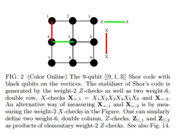

Since OP seems to already understand the Shor code, let's first see how one would decode the error syndromes in the Shor code. The Shor code is just the concatenation of two repetition codes: an outer X-type code, each qubit of which further encoded in an inner Z-type code. For concreteness, below I will consider specifically the 9-qubit Shor code, which means both repetition codes are 3-qubit codes. It may help to visualize the qubits as in a grid:
1 2 3
4 5 6
7 8 9
Here each row (e.g. qubits 1, 2, and 3) corresponds to one instance of the inner Z-type code.
X errors and Z errors in the Shor code can be corrected individually. To correct X errors, we look at the two Z-type measurements in each row (remember that Z-type measurements are what help correct X errors, and vice versa), such as $Z_1Z_2$ and $Z_2Z_3$. If they are both +1, then there was probably no X error in this block. If one or two results are -1, then which ones are -1 will indicate which qubit among qubits 1, 2, and 3 is probably flipped, and the error can be corrected by applying a physical X gate. (If 2 or 3 X errors have happened in this row, then this goes horribly wrong and results in a logical X error.)
Meanwhile, to correct Z errors, we have to look at each row as a whole, and apply X measurements to two entire rows. This is trickier to implement, requiring weight-6 stabilizer measurements such as $X_1X_2X_3X_4X_5X_6$ (this works because e.g. $X_1X_2X_3$ is a logical X operator for the inner code in the top row). The results of those weight-6 stabilizer measurements are then used as error syndromes for the outer X-type repetition code.
One helpful way to understand this is that we no longer care about whether each of qubits 1, 2, and 3 individually has a Z error; we only care about whether qubits 1, 2, and 3 together has an odd number of Z errors. We don't care about whether a Z error happened on qubit 1 or qubit 2 because $Z_1Z_2$ is a stabilizer anyway.
Bacon-Shor code
The Bacon-Shor code corrects both X errors and Z errors in the way the Shor code corrects Z errors. So we still have weight-6 X-type stabilizer measurements such as $X_1X_2X_3X_4X_5X_6$, but also Z-type ones such as $Z_1Z_2Z_4Z_5Z_7Z_8$.

The trick is that even though both types of stabilizers are weight-6, we can actually measure both with only weight-2 Pauli measurements. For example, instead of directly measuring $X_1X_2X_3X_4X_5X_6$, we can measure the "gauges" $X_1X_4$, $X_2X_5$, and $X_3X_6$. This was not possible for the Shor code because e.g. $X_1X_4$ would anti-commute with the stabilizer $Z_1Z_2$. Of course, this works symmetrically for the Z-type measurements — instead of measuring $Z_1Z_2Z_4Z_5Z_7Z_8$ we still just measure $Z_1Z_2$, $Z_4Z_5$, and $Z_7Z_8$. Since those are only gauges and not stabilizers, we don't care if they anti-commute among themselves.
If you smell something weird here (e.g. "Don't the gauge measurements disturb the code state?"), it's probably one of the peculiarities of the subsystem code, which other answers have mentioned. I can add more information if you have any concrete questions to ask.

The $9$-qubit Shor code $[[9,1,3]]$ (qubits laid in a $3\times 3$ lattice) is the smallest member in the family of $m^2$-qubit Bacon-Shor code(s) $[[m^2,1,m]]$ (qubits laid in a $m\times m$ lattice). Shor's code, as you know, can correct both Pauli sign flip and Pauli bit-flip errors in a single qubit. Moreover, to correct any single-qubit error (with a high probability), it is sufficient to be able to correct against any single qubit Pauli error.[1]
Now, Bacon-Shor code(s) is(/are) a generalization of this concept to noise models where the qubits in a code block are subject to both bit-flip errors with probability $p_X$ and dephasing errors with probability $p_Z$. The noise is assumed to act independently on each qubit and the $X$ and $Z$ errors are uncorrelated.
In (Napp and Preskill, 2013) the authors find that the optimally-sized Bacon-Shor code for equal $X$ and $Z$ errors rate $p$ is given by $m=\frac{\log 2}{4p}$ and for that optimal choice they can bound the logical $X$(or $Z$) error rate as $\tilde p(p) \lesssim \exp(\frac{-0.06}{p})$[2].
It is also possible to work with asymmetric Bacon-Shor codes with qubits in an $n \times m$ array. Asymmetric codes can have better performance when, say, $Z$ errors are more likely than $X$ errors[3].

Contrarily to Shor's code, these stabilizers cannot identify the precise qubit on which a bit-flip occurs, they can only identify the column in which it occurs. - Quantum Error Correction
For the $[[n^2, 1, n]]$ Bacon-Shor code the qubits are laid out in a 2D n × n square array. It is also possible to work with asymmetric Bacon-Shor codes with qubits in a n × m array. - Quantum Error Correction for Quantum Memories pg. 34
