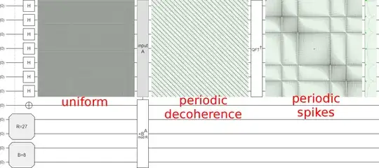

Another way to see that this works is by simulating it. From the results you can see that, as soon as the modular-exponentiation into the ancillae has happened, the density matrix of the input has been decohered in a very particular periodic way. And that the inverse QFT of this decohered density matrix has magnitude spikes at the correct places:
Notice that this is all in place even though the ancillae were not measured. Measuring them changes none of the density matrices.
