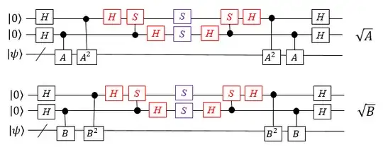

In more detail, given two unitary operators $A,B$ acting on an $n$-qubit state $|\psi\rangle$, where $A$ and $B$ are inverses of each other, e.g., $AB=BA=I$, and both $A$ and $B$ are of order $4$, e.g., $A^4=B^4=I$, we wish to find a good circuit for $\sqrt A\sqrt B$, as this might be part of a product formula for Hamiltonian simulation.
Initially we can construct the square roots for each of $A$ and $B$ separately, noting that because the eigenvalues of $A$ and $B$ are the fourth roots of unity, e.g., $\pm i, \pm 1$, we can use two ancillae for phase estimation with $S$ gates that rotate the ancillae and take the roots:
Separate Roots
The last Hadamard gates are included to emphasize that the ancillae all revert back to $|0\rangle$.

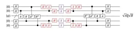

Parallel Circuit
Because $[\sqrt A, \sqrt B]=0$, i.e. the above circuits commute, we can execute them in parallel with four ancillae (two at the top and two at the bottom):
Parallel Roots
With the above parallel circuit, we have six controlled applications each of $A$ and $B$, sixteen Hadamard gates, and eight $S$/$CS$ gates.

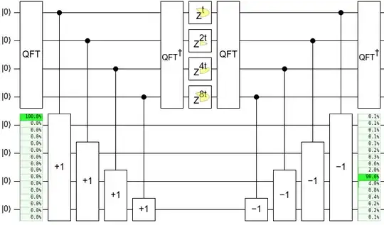

Here's a circuit that does it.
[rest of your question]
Congrats, you've rediscovered that phase kickback can be used to implement powers of operations! But it's not just limited to cases where the eigenvalues are multiples of i, such as the fractional fourier transform. It works for anything (but only efficiently if you can implement big powers of the operation). For example, you can use it to turn incrementing into a continuous operation:
