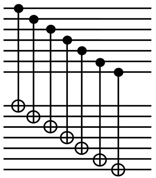

For a logical two qubit gate between two logical qubits, a typical example of a transversal operation consists in saying that the physical qubit $i$ of the first logical qubit will only interact with the physical qubit $i$ of the second logical qubit. For instance the image below describes a transversal cNOT for the seven qubit Steane code (in this case all the physical gates are identical, but again this is not a requirement in general)
The interest in considering such gates is that they don't propagate errors. Typically if a given physical qubit in one logical qubit has an error, it won't propagate on two physical qubits having an error on this same logical qubit after the transversal implementation (because two physical qubits within the same logical one will not interact).
Of course, for two-qubit gates, one error might induce two errors, but they will affect two different logical qubits. It is not a problem because the danger only comes from having multiple physical errors inside the same logical qubit. Different logical qubits are associated with independent error correction procedures and you can resist single-qubit errors occuring on different logical qubits.
