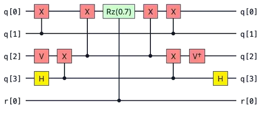

This decomposition is now built into pytket.
As pointed out by the accepted answer, you can make a controlled Pauli string rotation (aka a controlled Pauli gadget) by only controlling on the central $Z$ rotation. This is way more efficent in terms of circuit complexity than naively controlling on the other operations.
Here's an example for $\theta=0.7$ and with the Pauli string $ Z \otimes Z \otimes Y \otimes X$.
More generally, there's a simple pattern for when you can do this. If the base gate $U$ in your controlled gate is of the form
$$ \begin{equation} U = V \, A \, V^\dagger, \end{equation} $$
then it is sufficent to only control on the central $A$ operation. You can see that the above circuit fits this conjugation pattern. I wrote a short blog post on this.
Here's the pytket code to generate the controlled Pauli operation shown above.
from pytket.pauli import Pauli
from pytket.circuit import PauliExpBox, QControlBox
zzyx_box = PauliExpBox([Pauli.Z, Pauli.Z, Pauli.Y, Pauli.X], 0.7)
Controlled Pauli gadget with a single control.
controlled_pauli = QControlBox(zzyx_box, 1)
