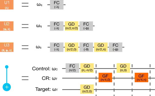

But what do "GD", "GF" or "buffer time" represent? They are base physical operations, i.e. the operations that will be performed on the physical qubit. These physical operation are then used to implement some base quantum gates. You can find the decomposition of the 4 base quantum gates of the IBM Q backends in terms of these physical operations on the IBM Q 5 Tenerife chips page. I copied the illustration below.
Base operation decomposition
Along with "GD" and "GF", there is a physical "FC" operation that does not appears in the timings. This is because this "FC" operation just "changes the frame of the following pulses" (citing Jay Gambeta from a conversation on the QISKit Slack), and so the "FC" operation has a cost (time of application) of 0.
The "buffer time" is just a pause time between each physical operation application.
So finally we can compute the time needed to apply each base gate on this specific backend:
  1. U1: 0ns
  2. U2: 70ns = 0ns + 60ns + 10ns (buffer) + 0ns
  3. U3: 140ns = 0ns + 60ns + 10ns (buffer) + 0ns + 60ns + 10ns (buffer) + 0ns
  4. CX: 560ns = 0ns + 60ns + 10ns (buffer) + 200ns + 10ns (buffer) + 60ns + 10ns (buffer) + 200ns + 10ns (buffer)
From these timings, you can deduce the number of operations per second that the ibmqx4 backend can perform.
