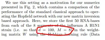

However, in this[$\dagger\dagger$] paper on page 6 they claim that they used the HHL09 algorithm to estimate the pseudoinverse of $A$ which of size ~$200\times 200$. In that paper, $A$ is defined as:
$$A := \begin{pmatrix} W - \gamma \Bbb I_d & P \\ P & 0 \end{pmatrix}$$
where $P$,$W$ and $\Bbb I_d$ are all $d\times d$ matrices.
In the H1N1 related simulated Lloyd et al. have claimed to have made, $d = 100$. And they further claim that they used the HHL09 algorithm to estimate the pseudo-inverse of $A$ (which is of size $200\times 200$). That would need a minimum of $7\lceil{\log_2(200)\rceil}+1 = 7(8)+1 = 57$ qubits to simulate. I have no idea how they could possibly do that using the current quantum computers or quantum computer simulations. As far as I know, IBM Q Experience at present supports ~$15$ qubits (that too it isn't as versatile as their $5$-qubit version).
