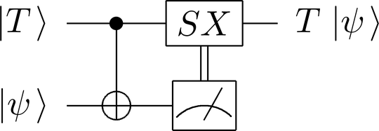

Let us zoom out a bit. The magic state gadget replacing the $T$ gate looks like the following:
If we can do the Clifford gates and the measurement fault-tolerantly, which we can for a suitable stabilizer code, this circuit is fault-tolerant. However, the problem is that the preparation of the magic state $|T\rangle = \frac{1}{\sqrt{2}}(|0\rangle + e^{i\pi/4}|1\rangle)$ might not be.
