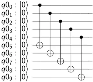

from qiskit import *
from qiskit.tools.visualization import *
# build a register with k targets and k ancillas
k = 5
qr = QuantumRegister(2*k)
circ = QuantumCircuit(qr)
# apply cx between ancillas and targets
for i in range(k):
    circ.cx(qr[i], qr[i+k])
circuit_drawer(circ)
original

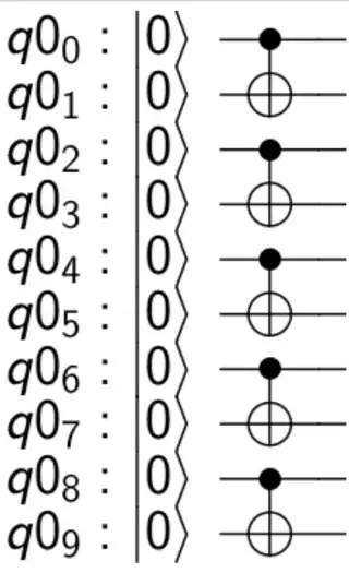

# specify the desired interleaving
# {0: 0, 1: 2, 2: 4, 3: 6, 4: 8, 5: 1, 6: 3, 7: 5, 8: 7, 9: 9}
new_qubit_map = {i: 2*i if i < k else 2*(i-k)+1 for i in range(len(qr))}
# create the same circuit, but with the new interleaving
circ_2 = QuantumCircuit(qr)
for i in range(k):
    circ_2.cx(qr[new_qubit_map[i]], qr[new_qubit_map[i+k]])
circuit_drawer(circ_2)
interleaved

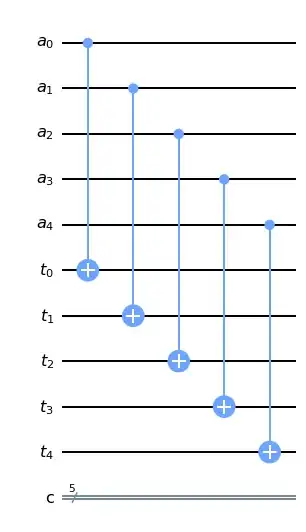

Firstly, use separate quantum registers a and t instead of the default single qr register.
from qiskit import QuantumRegister, ClassicalRegister
n = 5
a = QuantumRegister(n, 'a')
t = QuantumRegister(n, 't')
c = ClassicalRegister(n, 'c')
qc = QuantumCircuit(a,t,c)
qc.cx(a,t)
qc.draw()
Here's the output you would get:
a register is at top and t is at bottom

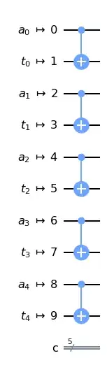

qct = transpile(qc, initial_layout=sum(zip(a,t),()))
qct.draw()
Here's the output:
a[i] qubit is preceeded by t[i]
