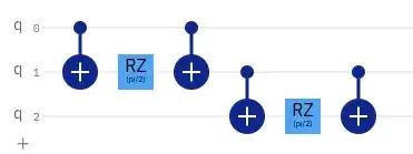

In each of the two summands there exists a unit operator which can be completely ignored from the circuit. Now, for the operator $Z \otimes Z$ the curcuit would read $$ \mathrm{CNOT} R_z(2t) \mathrm{CNOT}: $$ enter image description here
My question is whether as the generalization to the 3 lattice sites Hamiltonian is as simple forward as this: enter image description here
Of course the $R_Z$ gate runs for $2t$ according the unitary $U(t)$. Finally, does this generalize as simply to the $n$ lattice site Ising model?

If you know the circuit that corresponds to the unitary $U_{zz}$ for $Z_1Z_2$, then you also can also be sure that the same circuit will correspond to $U_{zz}$ for $Z_2 Z_3$, except that the circuit will apply to qubits 2 and 3 instead of to qubits 1 and 2. This generalizes to any two qubits in your $n$-site Ising model, for example $U_{zz}$ for $Z_4Z_{13}$ will have the same circuit as $U_{zz}$ for $Z_1Z_2$ except that the gates will apply to qubits 4 and 13 instead of 1 and 2.
The last remaining aspect of your question is perhaps themost interesting one. If you can factorize a unitary $U$ into $U=U_AU_B$, and you know the circuit that corresponds to $U_A$ and $U_B$, then yes you implement each circuit one after the other, and since in your case $U_A$ and $U_B$ commute, it doesn't even matter the order in which you implement them, meaning that you could also switched the order so that your sub-circuit for $U_{zz}$ on qubits 1 and 2 would be switched with your sub-circuit for $U_{zz}$ on qubits 2 and 3. This also generalizes to $n$-sites in your model, or $n$ different unitary operators and their corresponding $n$ sub-circuits!

You can also verify that this circuit will correctly implement $U_AU_B$ by defining the gates and circuits as follows:
CNOT = [1 0 0 0 ; 0 1 0 0 ; 0 0 0 1; 0 0 1 0 ];
CNOT_12 = kron(CNOT,eye(2));                    % CNOT on q1q2
CNOT_23=kron(eye(2),CNOT);                      % CNOT on q2q3
RZ_piBy2=[exp(-1i*pi/4) 0 ; 0 exp(1i*pi/4)]*2;  % Rz(pi/2) for 2 units of time
RZ_qubit2=kron(eye(2),kron(RZ_piBy2,eye(2)));   % Rz on q2
RZ_qubit3=kron(eye(4),RZ_piBy2);                % Rz on q3
CNOT_12*RZ_qubit2*CNOT_12*CNOT_23*RZ_qubit3*CNOT_23
