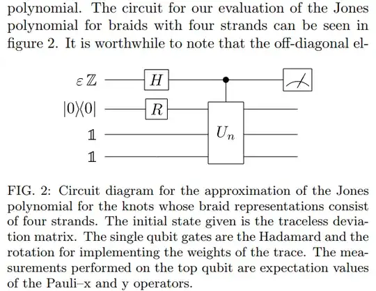

You have mentioned five papers in the question, but one paper that remains unmentioned is the experimental implementation in 2009. Here you will find the actual circuit that was used to evaluate a Jones polynomial:
This might be the closest you will get to a "more familiar" presentation of the algorithm, as interest in the Jones polynomial and in DQC-1 have decayed a bit since 2009.
More details on this experiment can be found in Gina Passante's thesis.
