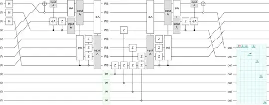

Here is a circuit that prepares the state $\text{AND}_{1,2} \cdot \text{AND}_{1,3} \cdot \text{AND}_{2,3} \cdot \text{AND}_{1,2,3} \cdot |+\rangle^{\otimes 3}$ and then consumes it to perform a CCCZ:

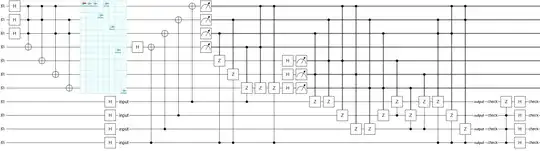

And here is a circuit that turns a $|W_{8}\rangle$ state into the state $\text{AND}_{1,2} \cdot \text{AND}_{1,3} \cdot \text{AND}_{2,3} \cdot \text{AND}_{1,2,3} \cdot |+\rangle^{\otimes 3}$:
(Note: the circuit has Toffolis inside one of the controlled XOR gates after the W8 state is prepared, but these Toffolis are uncomputing a value so they can be replaced with measurement based uncomputation.)
Put the two together, and you have a circuit that performs a CCCZ by consuming a $|W_8\rangle$ state.
