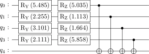

I actually found the solution to my problem - with one caveat: the amplitudes $a,b,c,d$ can not be completely arbitrary. An $n$-qubit superposition state with even parity will have $2^{n-1}-1$ free parameters, while the approach presented below only allows for $2(n-1)$ parameters. This still solves my problem though, so I will share the approach anyways:
Given $n$ qubits initialized as $|0\rangle$, one can act with $R_y(\alpha_i)$ and $R_z(\beta_i)$ on all qubits $i$, excluding one of them (for me this will be the last one). This will put every qubit in an arbitrary superposition state $a|0\rangle + b|1\rangle$.
Then one just needs to apply $n-1$ CNOT gates with control qubits being the first $n-1$ qubits and the qubit acted upon being the last qubit (rotation angles are random):
This yields a superposition of all states with even parity. For odd parity, one can start with the last qubit in the $|1\rangle$ state.

To do this in general is equivalent to creating an arbitrary $n-1$-qubit state, and then using the pattern of controlled-nots to determine the bit value of the final qubit, as you did in your solution.
Creating an arbitrary $n$ qubit state is a standard, well-studied, but complex task which I'm not going to elaborate on here. You might look, for example, at this question and answer.
