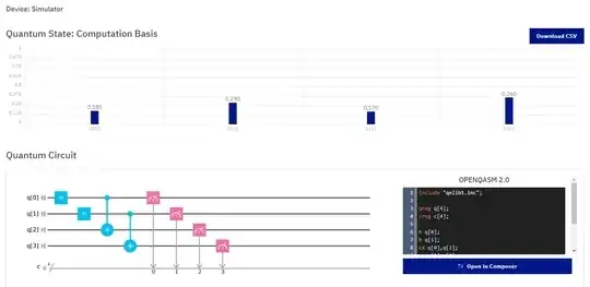

I am interested in a quantum algorithm that has the following characteristics:
  1. output = 2n bits OR 2 sets of n bits (e.g. 2 x 3 bits)
  2. the number of 1-bits in the first set of n-bits must be equal to the number of 1-bits in the second set. E.g. correct output = 0,0,0, 0,0,0 (both 3-bit sets have zero 1-bits); 1,0,0, 0,1,0 (both 3-bit sets have one 1-bit); 1,1,0, 0,1,1 (both 3-bit sets have two 1-bit)
  3. Each time the quantum algorithm runs it must randomly return one of the possible solutions.
Any idea how I can best implement such an algorithm on a quantum computer ?
FYI I have tried the following algorithm (where n = 2 ) but it missed the 2 answers 0110 and 1001: enter image description here
