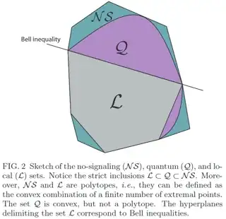

A standard representation of the relations between these sets, given in the review by Brunner et al., is
One notable feature of this is that while $\mathcal L$ and $\mathcal{NS}$ are polytopes, that is, the convex hull of a finite number of points, $\mathcal Q$ is represented as having a boundary that is non-flat in some sections.
I wouldn't call this feature surprising, but is there an easy way to see why this is the case?
