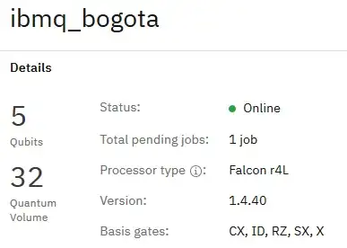

You can view the basis gates that supporting at the hardware level for IBM's hardware through your dashboard. All the devices with more than 1 qubit have the same set of basis gates $\{CX, ID, RZ, SX, X \}$. Below is a screenshot of a particular device named ibmq_bogota.
