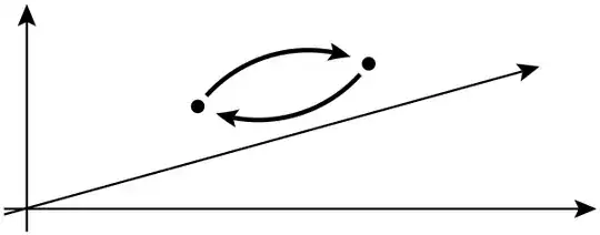

The first thing to do is to think topologically: make sure you understand why a coffee cup is the same thing topologically as a donut.
Now, imagine we swap two identical particles, and do it again, so that we are back where we started. Apply this topological thinking to the paths taken by the particles: it is the same as doing nothing.
Here I show a picture of this, where one particle is dragged around another particle. Topologically, the path taken can be deformed back to the "do nothing" path.
particle monodromy
The square root of this operation is a swap:
particle swap
Since the square root of 1 is either +1 or -1, a swap affects the state by multiplying by either +1 (for bosons) or -1 (for fermions.)

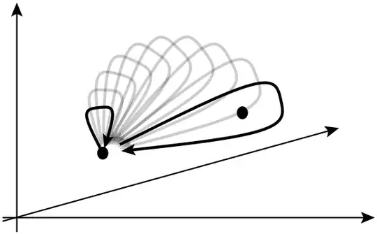

To understand anyons, we are going to do the same analysis, but with one less dimension. So now a particle winding around another particle is not topologically the same as the "do nothing" operation:
We need the extra third dimension to untangle the path of the anyon, and since we can't do this topologically, the state of the system could be modified by such a process.

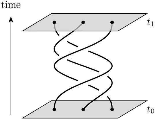

Things get more interesting as we add particles. With three anyons, the paths taken can get tangled, or braided in arbitrary ways. To see how this works it helps to use three dimensions: two space dimensions and one time dimension. Here is an example of three anyons wandering around and then returning back where they started:
three anyons braid
Long before physicists started to think about anyons, the mathematicians already worked out how these braiding processes combine to form new braids or undo braids. These are known as "braid groups" in work that dates back to Emil Artin in 1947.
Like the distinction between Bosons and Fermions above, different anyon systems will behave differently when you do these braid operations. One example of anyon, known as the Fibonacci anyon, are able to approximate any quantum operation just by doing these kinds of braids. And so theoretically we could use these to build a quantum computer.
