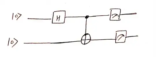

I am trying to understand the steps of how make a state preparation circuit from a quantum state. For making my question more clearer, for example, for the state is $\frac{|00\rangle+|11\rangle}{\sqrt{2}}$, the state preparation circuit is :enter image description here

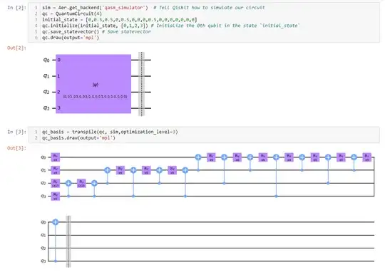

I want to draw the state preparation circuit for the quantum state $\frac{1}{2}( |1000\rangle + |0100\rangle + |0010\rangle + |0001\rangle)$.
I was following this lecture. I am not able to completely understand the steps used to draw circuits. It would be great if someone can help me with this question.

I have added an image for your reference. If you have to create any state but don't know the circuit then you can always initialize the state then using qiskit transpile, you can decompose the circuit in terms of basis gates
