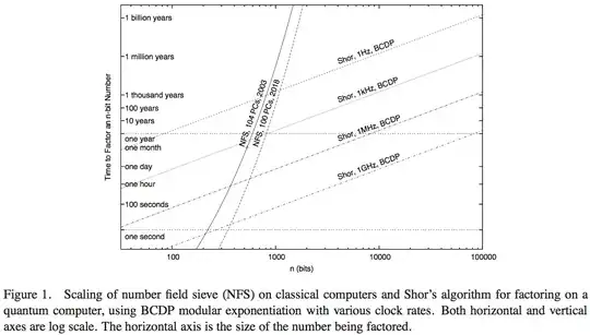

Van Meter, Itoh, and Ladd attempt to compare the performance of Shor's algorithm with available computing technology performing the Number Field Sieve (the best known classical algorithm for factorisation). I have not had the time to plumb through the details of the paper — a superior answer could likely be obtained by doing so — but Figure 1 of that article allows us to make a reasonable numerical estimation:
Here, the steep curves represent the computing time of classical computing networks. The curve labeled 'NFS, 104 PCs, 2003' seems to indicate computations (and the projected computing time) of one hundred and four personal computers circa 2003, as reported by RSA Security Inc. in 2004 [http://www.rsasecurity.com/rsalabs/node.asp?id=2096].
We will carry out a Fermi calculation. Let us assume that the curve corresponds to a computation on 104 essentially identical computers, and let us presume that $n$ computers carrying out number field sieve can carry out $n \cdot v$ computations per second of Number Field Sieve, where $v$ is the number of operations per second which a single computer can carry out. A quick web search suggests the speed of a good commercially available PC circa 2003 was about 2GHz. Assuming that the computers were performing one logical operation per clock cycle, the classical computation in 2003 was effectively operating at about $2 \times 10^{11}$ operations per second. A hypothetical benchmarking of Shor's algorithm would have to be made against a quantum computer performing at a comparable clock speed.
Unfortunately the lowest curve for quantum algorithms represents a clock-rate of $10^9$, so the point at which a hypothetical realisation of Shor's algorithm would surpass this performance is not on the graph shown. However, there is some interesting information which is shown.
  • Despite a operations-per-second advantage of a factor of 200 or more, the plot does indicate when this 200GHz classical NFS implementation is surpassed by a 1GHz quantum computer performing Shor's algorithm (at about 200 digit numbers) and by a 1MHz quantum computer (at about 330 digit numbers).
  • We also have a curve projecting the performance "in 2018", representing 1000 times the classical computation power: the intercepts with the 1GHz and 1MHz quantum computers are at 350 bit numbers and 530 bit numbers.
The increase in the crossing points against quantum computations, from the computation in 2003 to the projected one in 2018, representing a clock-speed boost of 1000, is a factor of about 5/3. From this we can estimate that the computational advantage to the size of numbers that can be quickly solved by a classical computer, due to a speed increase of a factor of 200, is roughly 7/6. Then we can estimate that the crossing point of a single 1GHz classical computer performing NFS, with a 1GHz quantum computer performing Shor's algorithm, is at about 170 bit numbers.
The bottom line — a precise answer will depend on many technical assumptions which can change the precise result significantly, so it is better to seek a rough estimate. But this question has been researched at least once before, and making some number of assumptions and extrapolations on performance based on classical performance in 2003, it seems that Shor's algorithms will outperform the best known classical algorithm on an operation-by-operation basis for numbers around 170 bits.
