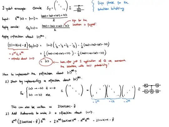

To show in more detail what's going on we can calculate a concrete example. In general, Grover's algorithm apply the Grover operator $Q$ defined as $$ Q = H^{\otimes n}S_0 H^{\otimes n} S_f $$ where $H$ is the Hadamard gate, $S_0 = 2|0\rangle^{\otimes n}\langle 0|^{\otimes n} - \mathbb I$ is a reflection about the $|0\rangle^{\otimes n}$ state and $S_f$ is the oracle. Sometimes we group the first three operations and call it "diffusion" because it equals a reflection about the maximally superposed state: $$ Q = S_{+} S_f $$ with the diffusion operator $S_+ = 2|+\rangle^{\otimes n}\langle +|^{\otimes n} - \mathbb I$.
In the standard formulation of Grover's algorithm, we initialize a maximally superposed state and apply $Q$ a specific number of times $p$ to amplify the amplitude of the solution bitstring: $$ Q^p H^{\otimes n} |0\rangle^{\otimes n}. $$ If you know the number of solutions you can calculate $p$, otherwise we usually apply different powers of $Q$, measure, and check if the output is a solution.
Let's look at your particular example to see that the diffusion operator really amplifies the solution state. I've attached that as notes, since the math takes a bit long to TeX
