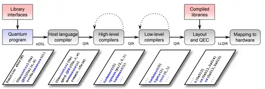

To get something more similar to how we usually program classical computers one needs some kind of compilation pipeline, mapping a given computation, expressed in an abstract high-level language, down to the specific hardware details of a given architecture. This is still a work in progress, but there are people working in this direction. A relevant work that comes to mind is 1604.01401. Here is the pipeline proposed in this paper:
In theory, having software suites implementing such a pipeline would allow to write abstract code and have automatically compiled down to work on, say, superconducting chips as well as optical or ion-trap quantum computers.
In practice, there are so many things to still work out (first of all how to actually make scalable quantum computers) that it is hard to say how such scheme will work.
