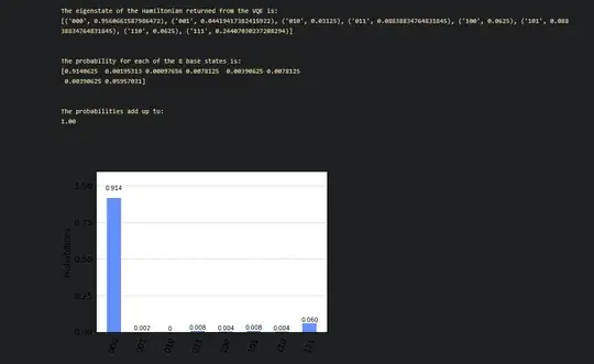

Now I run this snippet of code 6-7 times. First and second time, I get the following result (with a bit of a difference in probabilities, obviously)

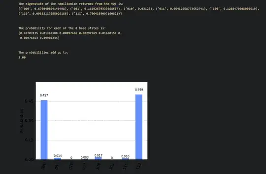

The third time, I get the following result, which is a completely "flipped" version of the one I'm expecting

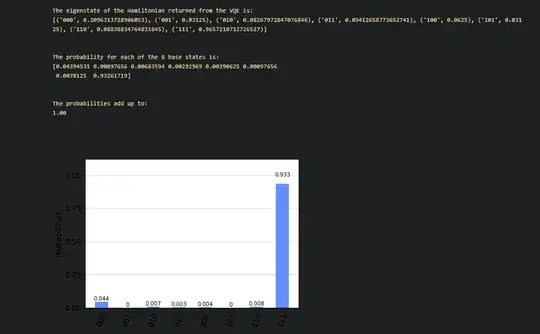

The last time I run it, I get the following results
It really makes no sense with my knowledge why this happens. I obviously chose a very simple case to demonstrate here, just to prove my point without having to mess with the math. You can do the same for h=100 where you would expect an equal superposition. The results look overall better (statistically speaking), but you will occasionally get a result that makes no sense.
