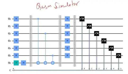

I have just started learning Qiskit and to begin I tried running the Bernstein Vazirani Algorithm(secret number detector) on qasm_simulator and the ibmq_16_melbourne system and compared their results. My results on the Qasm simulator exactly matches the secret number, but I am getting wrong result on the real system. Please review my codes, circuits and results below:
import qiskit
from qiskit import IBMQ
import time
from qiskit import *
from qiskit.tools.visualization import plot_histogram
from qiskit.tools.visualization import plot_bloch_multivector
import matplotlib.pyplot as plt
from qiskit.tools.monitor import job_monitor
#IBMQ.save_account('Account key',overwrite=True)  #  Run it for once
6 bit secret number
secretNumber= '101001'

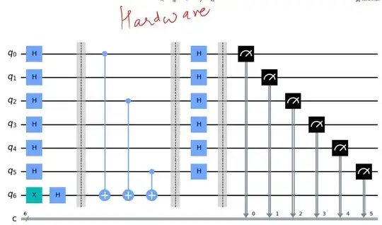

circuit= QuantumCircuit(6+1,6) # 6 qubit for secret no. +1 qubit circuit. h([0,1,2,3,4,5]) circuit.x(6) circuit.h(6) circuit.barrier()
splitting the string into char
splitSecretNumber= list(secretNumber) lengthofSecretNumber= len(splitSecretNumber)
x=0 while(x< lengthofSecretNumber): if(str(splitSecretNumber[x])=='1'): circuit.cx(int(x),6) x=x+1
circuit.barrier() circuit.h([0,1,2,3,4,5]) circuit.barrier() circuit.measure([0,1,2,3,4,5],[0,1,2,3,4,5]) circuit.draw(output="mpl")

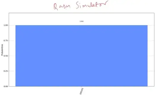

simulator= Aer.get_backend('qasm_simulator') simulationResult = execute(circuit,simulator, shots=1).result() counts= simulationResult.get_counts() print(counts) plot_histogram(simulationResult.get_counts(circuit)) plt.show()
The histogram and circuit obtained are for Qasm simulator are as below: enter image description here

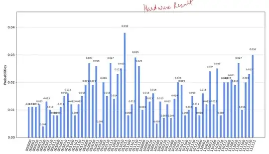

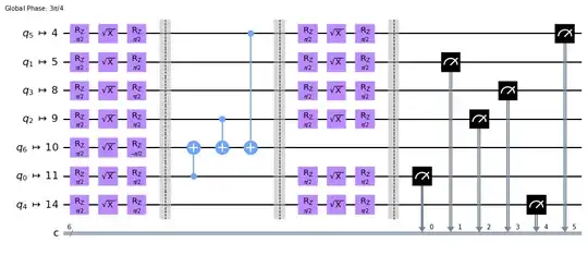

IBMQ.load_account() provider=IBMQ.get_provider('ibm-q') realMachine= provider.get_backend('ibmq_16_melbourne') result = execute(circuit,realMachine, shots=1000).result() counts= result.get_counts() print(counts) plot_histogram(counts) plt.show()
The histogram and circuit obtained are for ibmq_16_melbourne system are as below: enter image description here enter image description here
Please help, I am completely stuck. I could not find what is going wrong.

The @epelaaez explanation is on the spot on how noise works.
In this answer I would like to focus more on how to reduce that noise. For that, let's introduce the notion of the Qiskit transpiler. The transpiler adapts the circuit to run it in the backend.

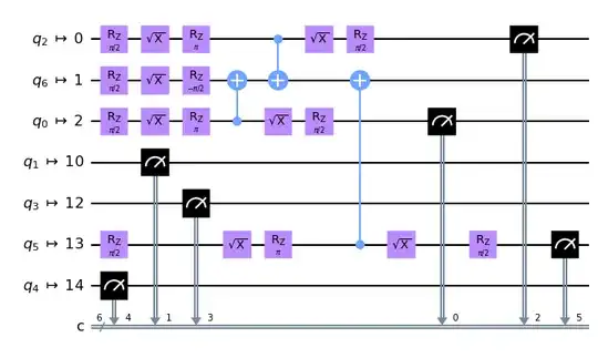

The circuit that you are running in ibmq_16_melbourne is the following:
from qiskit import transpile
realMachine_circuit = transpile(circuit, realMachine) realMachine_circuit.draw('mpl', idle_wires=False)
optimization_level=1
The depth of this circuit (check realMachine_circuit.depth()) is 22 layers, which has the T1 and T2 noise effect described by @epelaaez. Also has the following amount of gates(check realMachine_circuit.count_ops()):
OrderedDict([('rz', 26),
             ('cx', 18),
             ('sx', 13),
             ('measure', 6),
             ('barrier', 3)])
More gates means more single (for rz and sx) and 2-qubit (for cx) gates error.

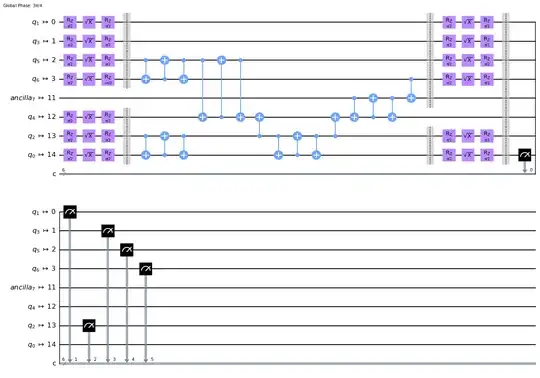

Therefore, for reducing noise, the option is to reduce the depth of the circuit and the amount of gates used in the circuit. The easier way to do this is to tell the transpiler to spend more computational resources in optimization. You can do that with the parameter optimization_level, which maxim number is 3. Here, the result:
realMachine_circuit = transpile(circuit, realMachine, optimization_level=3)
optimization_level3
This results in a better circuit:
print('depth: ', realMachine_circuit.depth())
print('count_ops: ', list(realMachine_circuit.count_ops().items()))
depth:  10
count_ops:  [('rz', 26), ('sx', 13), ('measure', 6), ('barrier', 3), ('cx', 3)]
Other aspect to consider is the effect of barrier. While I understand you put them there for pedagogic reasons, they do have meaning for the transpiler. The transpiler does not optimize gates across barriers. So you can remove them before transpiling like this:
from qiskit.transpiler.passes import RemoveBarriers
realMachine_circuit = transpile(RemoveBarriers()(circuit), realMachine, optimization_level=3)
depth:  9
count_ops:  [('rz', 11), ('sx', 7), ('measure', 6), ('cx', 3)]
optimization_level3_without_barriers

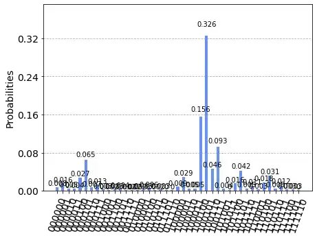

Now, with all this together, let's execute in real hardware to see the result:
job = execute(RemoveBarriers()(circuit), realMachine, optimization_level=3)
counts= job.result().get_counts()
final result
Now, the correct result is "more evident". Here is the most frequent result (in this case, matching the simulation):
counts.most_frequent()
'100101'
luciano
  • 6,084
  • 13
  • 34
That’s just how real quantum computers work. The QASM simulator is able to simulate ideal conditions where there is no noise in your qubits/circuit. However, you cannot avoid noise when running on real hardware. Here you can find information about the specific device you’re talking about.
