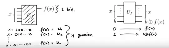

We are given a function $f:\{0,1\}^n\to\{0,1\}$ as a black box. We know that $f(x)=u.x$ (i.e. $u_1x_1+u_2x_2+...+u_nx_n (\text{mod 2})$) for some hidden $u\in\{0,1\}^{n}$. How do we figure out $u$ with as few queries to $f$ as possible?
They say that we need to follow a two step procedure for figuring out $u$ in minimum possible number of steps.

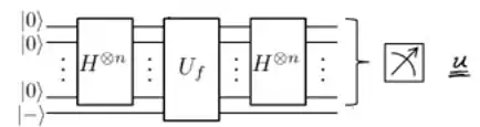

They further build a quantum gate like this:
Even this doesn't make sense to me. They're performing Hadamard transforms on a set of n-qubits having state $|0\rangle$ and then bit flip and again Hadamard transform. So we get back to where we were initially. How does an extra $|-\rangle$ state input help by outputting $- \oplus f(0...0)$? I'm not even sure what operation $\oplus$ stand for, here.

Starting from the beginning (a very good place to start, after all), the state $\left| 0\right\rangle^{\otimes n}\left| -\right\rangle$ is input into $H^{\otimes n}\otimes I$ (here, called the 'Fourier sample'). This generates the state $$\left(\sum_{x=\{0,1\}^n}\frac{1}{2^{n/2}}|x\rangle\right)\left|-\right\rangle = \frac{1}{2^{n/2}}\left(\left|0\right\rangle + \left|1\right\rangle\right)^{\otimes n}\left|-\right\rangle.$$ Now, we apply the operation $U_f$ (in this case, the bit oracle) to give $$U_f\left(\sum_{x=\{0,1\}^n}\frac{1}{2^{n/2}}|x\rangle\right)\left|-\right\rangle = \sum_{x=\{0,1\}^n}\frac{1}{2^{n/2}}|x\rangle\left|-\oplus f\left(x\right)\right\rangle.$$
The first point to note is that $\oplus$ is the classical XOR operation. What this gives is actually the phase oracle, so that we get $$\left(\sum_{x=\{0,1\}^n}\frac{1}{2^{n/2}}\left(-1\right)^{f\left(x\right)}\left|x\right\rangle\right)\left|-\right\rangle.$$ This is because $U_f\left|x\right\rangle\left(\left|0\right\rangle - \left|1\right\rangle\right) = \left|x\right\rangle\left|f\left(x\right)\right\rangle - \left|x\right\rangle\left|1\oplus f\left(x\right)\right\rangle = \left(-1\right)^{f\left(x\right)}\left|x\right\rangle\left(\left|0\right\rangle - \left|1\right\rangle\right)$. This is the 'set up a superposition...' point - all this means is to perform the operations required to set the qubits in the above state, which is a superposition of all possible states (with phase factors, in this case). In this case, this is just Hadamard, followed by a phase oracle.
Now, $x$ is just a classical bit string: $x = \prod_ix_i$, so $$H\left|x_i\right\rangle = \frac{1}{\sqrt{2}}\left(\left|0\right\rangle + \left(-1\right)^{x_i}\left|1\right\rangle\right) = \frac{1}{\sqrt{2}}\sum_{y=\left\lbrace0, 1\right\rbrace}\left(-1\right)^{x_i.y}\left|y\right\rangle.$$
This gives the property $$H^{\otimes n}\left| x\right\rangle = \frac{1}{2^{n/2}}\sum_{y\in\left\lbrace0, 1\right\rbrace^n}\left(-1\right)^{x.y}\left|y\right\rangle.$$
This gives the final state as $$\frac{1}{2^n}\left(\sum_{x, y=\{0,1\}^n}\left(-1\right)^{f\left(x\right) \oplus x.y}\left|y\right\rangle\right)\left|-\right\rangle.$$
We know that $f\left(x\right) = u.x = x.u$, giving $\left(-1\right)^{f\left(x\right) \oplus x.y} = \left(-1\right)^{x.\left(u\oplus y\right)}$. Summing over the $x$ terms gives that $\sum_x\left(-1\right)^{x.\left(u\oplus y\right)} = 0,\, \forall\, u\oplus y \neq 0$. This means that we're left with the term for $u\oplus y = 0$, which means that $u=y$, giving the output as $\left|u\right\rangle\left|-\right\rangle$, which is measured to obtain $u$.
