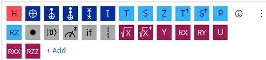

And now you can use the decomposed function to decomposed this circuit into the gates that is available within the composer: enter image description here
decomposed_circuit = transpile(circuit, basis_gates=['h', 'x', 'cx', 'ccx', 't', 'tdg', 's', 'sdg', 'p' , 'rz' , 'sx' ,'sxdg','rx', 'ry','rxx' , 'rzz',] )
q_0: ┤ RY(2.0344) ├┤ X ├┤ RY(0.17985) ├┤ X ├ ├────────────┤└─┬─┘└─────────────┘└─┬─┘ q_1: ┤ RY(2.3005) ├──■───────────────────■── └────────────┘
c: 2/═══════════════════════════════════════
Extracting the 'qasm' code:
print(decomposed_circuit.qasm())
print(decomposed_circuit.qasm()) OPENQASM 2.0; include "qelib1.inc"; qreg q[2]; creg c[2]; ry(2.0344439) q[0]; ry(2.300524) q[1]; cx q[1],q[0]; ry(0.1798535) q[0]; cx q[1],q[0];
Now take that and paste it in the QASM code block in the Circuit Composer
Now you have the initialize state that you wanted in the composer.
