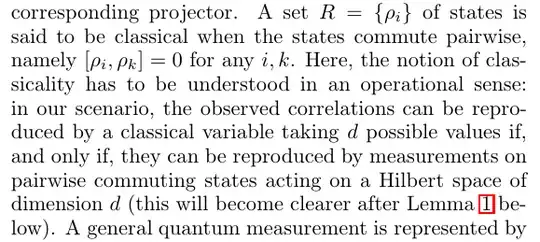

Edit: as asked, here is an example of the affirmation made in the first paragraph (taken from https://arxiv.org/abs/1207.2574):
classical reproduction of behaviors

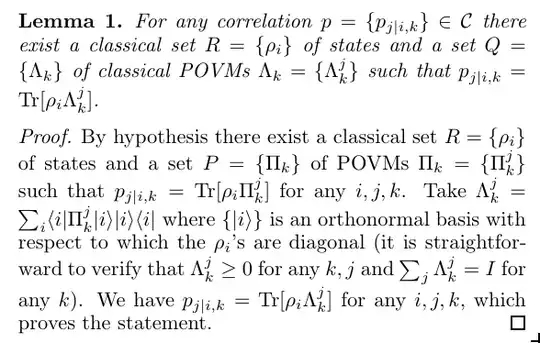

The lemma in question is below. But as far as I understand, it only shows that given the assumption that the probabilities are reproducible with classical (i.e. pair-wise commuting) states, then "classical measurements" (defined likewise) are also enough. Am I missing something here?

Usually, one defines classical states by first defining some "classical" orthonormal basis. Then a classical state is any state which is diagonal in this basis. Every classical state is then just some probability distribution written on the diagonal of some matrix. Note that all classical states expressed in this way commute.
On the other hand, you have a set of states that all pairwise commute. A set of pairwise commuting matrices can be simultaneously diagonalized. (You can show this by showing they must have the same eigenspaces). Therefore there exists some distinguished basis (orthonormal because we're working with Hermitian operators) in which all of these matrices are diagonal, recovering the above definition.

So... why commuting states?
I think the point of this definition is that if the states commute then there is no need for Alice to actually send quantum states to Bob. She might as well just send a classical message. Indeed, the authors point out after Lemma 1 that
Lemma 1 thus proves that every set of probabilities obtained with commuting states can be performed with classical states and classical POVMs. This clearly implies that commuting states may be equally regarded as classical variables, and commuting-element measurements as read-out of classical variables.
A possible argument to see why this is the case, loosely inspired by the proof of Lemma 1 (though in fairness I haven't really read the paper or the lemma in depth), is the following. If the states are pairwise commuting, $[\rho_i,\rho_j]=0$, then they can be simultaneously diagonalised: $$\rho_i = \sum_\ell \lambda_{i\ell}|\ell\rangle\!\langle \ell|,$$ for some $\lambda_{i\ell}\ge0$ and an orthonormal basis $\{|\ell\rangle\}_\ell$. We then have $$p_{j|i,k}=\operatorname{Tr}[\rho_i \Pi^j_k] = \sum_\ell \lambda_{i\ell} \langle \ell|\Pi^j_k|\ell\rangle.$$ What this is telling you is that, to reproduce the correlation, it is enough for Alice to send a classical message, and more specifically the value of $i$, to Bob's device. Bob's device will then sample one of the (fixed beforehand) states $|\ell\rangle$, with probabilities $\lambda_{i\ell}$, and measure it with the POVM $\{\Pi^j_k\}_j$, obtaining an outcome $j$.
For example, Alice presses the button "$i=1$". Her box sends a classical message saying "1" to Bob's box. Bob's box is then programmed to pick one of the states $|\ell\rangle$. More specifically, it will pick the state $|\ell\rangle$ with probability $\lambda_{i\ell}$ (again, these probabilities will have been chosen beforehand, when the boxes were calibrated). Say the box picks the value "$\ell=3$". Now, if Bob presses the button "$k=2$", his Box will perform the measurement corresponding to the POVM $\{\Pi_2^j\}_j$ on the state $|3\rangle$. The result will be some value of $j\in[1,N]$. Say $j=36\le N$. Repeating this circus an "infinite" number of times, Alice and Bob will collect the results and find the correct values of the conditional probabilities $p_{j|i,k}$.
When this type of thing is possible, then we say that the correlations $p_{j|i,k}$ are "classical", in the sense that no actual quantum states needed to be exchanged to get it.
