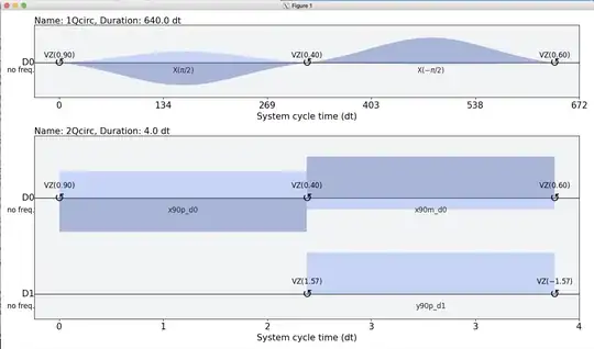

Can you help me to configure the FakeOpenPulse2Q() to produce more realistic pulses? The code below instantiates 2 circuits and generates the waveforms for each.
The top waveform frame is 1-qubit circuits with a single U3 gate using backend='ibmq_armonk' works fine. The bottom waveform frame is generated by FakeOpenPulse2Q() for a 2-qubit circuit using the same U3 gate on qubit 0 and the waveforms have the right structures but their shapes are simplified. enter image description here

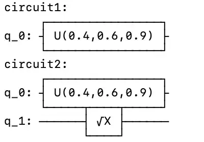

circ1 = QuantumCircuit(1,name='1Qcirc') circ1.u(0.4,0.6,0.9,0) qc1 = transpile(circ1, basis_gates=['u1','u2','u3'], optimization_level=1)
circ2 = QuantumCircuit(2,name='2Qcirc') circ2.u(0.4,0.6,0.9,0) circ2.sx(1) qc2 = transpile(circ2, basis_gates=['u1','u2','u3'], optimization_level=1)
sched1=schedule(qc1,backend1) sched2=schedule(qc2,backend2)
fig=plt.figure(1,facecolor='white', figsize=(14, 8)) ax1=plt.subplot2grid((3,1), (0,0), rowspan=1) ax2=plt.subplot2grid((3,1), (1,0), rowspan=2)
sched1.draw('IQXDebugging', axis = ax1, show_waveform_info = True) sched2.draw('IQXDebugging', axis = ax2, show_waveform_info = True)

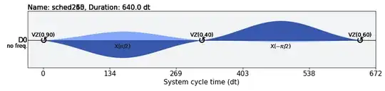

As a first step, you can create realistic pulses on FakeOpenPulse2Q() using the pulse builder. The default pulses instructions can be retrieved from the instruction schedule map. Here below the example for retrieveing the instruction from armonk and recreate that set of pulses for FakeOpenPulse2Q() using the pulse builder
1) Retrieve the pulse instructions for the gate (u3 in your case)
backend1.defaults().instruction_schedule_map.get('u3',qubits=[0]).instructions
this gives you the set of instructions below :
((0, ShiftPhase(-1.0*P2, DriveChannel(0))),
 (0,
  Play(Drag(duration=320, amp=(0.370467155866812-0.0762912966131609j), sigma=80, beta=-1.095928909587139, name='X90p_d0'), DriveChannel(0), name='X90p_d0')),
 (320, ShiftPhase(-1.0*P0, DriveChannel(0))),
 (320,
  Play(Drag(duration=320, amp=(-0.370467155866812+0.07629129661316089j), sigma=80, beta=-1.095928909587139, name='X90m_d0'), DriveChannel(0), name='X90m_d0')),
 (640, ShiftPhase(-1.0*P1, DriveChannel(0))))
  1. Create your calibration pulse program using the pulse builder
P2=0.90 P0=0.40 P1=0.60
from qiskit.pulse import play, build, shift_phase, ControlChannel, DriveChannel, GaussianSquare, Drag, Gaussian
with build(backend2) as pulse_prog: shift_phase(-1.0P2, DriveChannel(0)), play(Drag(duration=320, amp=(0.370467155866812-0.0762912966131609j), sigma=80, beta=-1.095928909587139, name='X90p_d0'), DriveChannel(0), name='X90p_d0'), shift_phase(-1.0P0, DriveChannel(0)), play(Drag(duration=320, amp=(-0.370467155866812+0.07629129661316089j), sigma=80, beta=-1.095928909587139, name='X90m_d0'), DriveChannel(0), name='X90m_d0') shift_phase(-1.0*P1, DriveChannel(0))
pulse_prog.draw('IQXDebugging', axis = ax, show_waveform_info = True)
