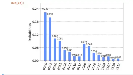

I have created a program that can add two 3-bit numbers together. When I simulate this program on a qasm_simulator it works as expected and I can add any two 3-bit numbers together such as: $011 + 110 = 1000$
However, when I try to get the result on real quantum hardware (IBMQ) it gets very unexpected results as seen below.
I know there will obviously be noise when using the quantum hardware but the results aren't even close to what they should be, does anyone know why?

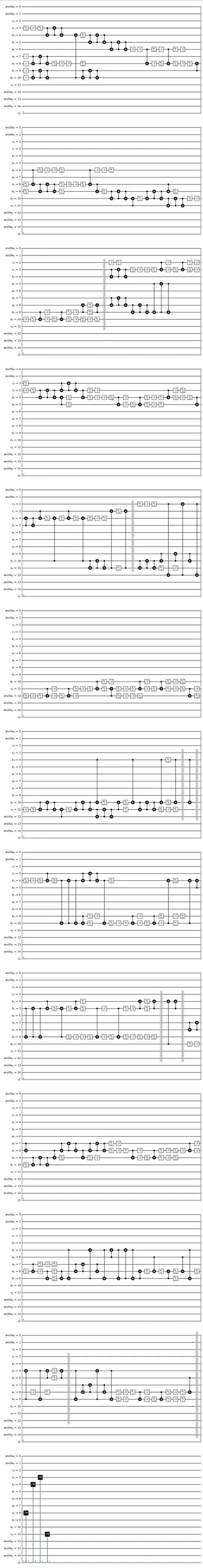

I think you underestimated how long your circuit really is....
When running your circuit on the hardware, it has to be transpile into the set of gates that is known to the hardware. For IBM machines, these are $\{ CX, ID, RZ, SX, X \}$ . Furthermore, there is a constraint on the qubit layout of the hardware as well. Not all qubits are connected. Thus there will be some overhead operation. At the end of it, your circuit is very long... and so all you read out is noise...
