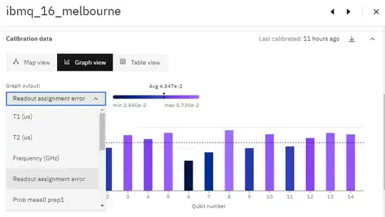

On the IBM Quantum Composer website, there are characteristics of qubit computers. For example, ibmq_16_melbourne. But there is no description anywhere of what:
T1(us), T2(us), Frequency (GHz), Readout assignment error, Prob meas0 prep1, Prob meas1 prep0, Readout length (ns), ID error, √x (sx) error, Single-qubit Pauli-X error, CNOT error, Gate time (ns) means.
Could you write down what they mean?
And why isn't there, for example, a Pauli-Z error, even though there is a Pauli-X error?
