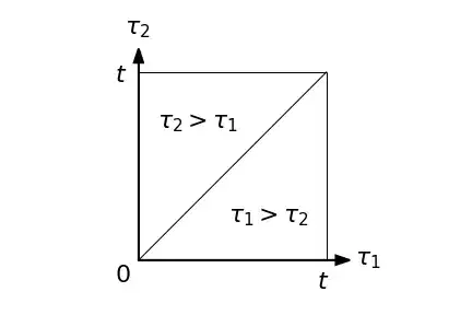

Now consider the square $[0,t] \times [0,t] \subseteq \mathbb{R}^2$.
square
Observe that the first term of $X_2$ above is a Riemann sum of the operator-valued function \begin{equation}\tag{2}\label{eq:F1} F(\tau_1, \tau_2) \equiv H(\tau_1) H(\tau_2) \end{equation} in the interior of the lower-right triangle where $\tau_1 > \tau_2$. You want to extend the definition of $F(\tau_1, \tau_2) $ to the upper-left triangle in such a way that its integral over the upper-left triangle is the same as the integral in the lower triangle. This of course is done by using the time-ordering "operator" $\mathcal{T}$:
\begin{equation}\tag{3}\label{eq:F2} F(\tau_1, \tau_2) \equiv \mathcal{T} \Big[ H(\tau_1) H(\tau_2) \Big] = \begin{cases} H(\tau_1) H(\tau_2) & \text{if $\tau_1 > \tau_2$}\\ H(\tau_2) H(\tau_1) & \text{otherwise} \end{cases} \end{equation}
The operator $\mathcal{T}$ does nothing in the lower-right triangle because there the order $\tau_1 > \tau_2$ is respected (so Eq. \eqref{eq:F2} properly defines an extension of Eq. \eqref{eq:F1}), and "corrects" the order that applies in the other triangle (that is $\tau_2 > \tau_1$) so that the Riemann sums of $F$ over the two triangles are the same. Now you can use this fact $$ -\sum_{i \neq j} \mathcal{T}\Big[ H(\tau_i) H(\tau_j) \Big] (\Delta \tau)^2 = -2\sum_{i>j} \mathcal{T}\Big[ H(\tau_i) H(\tau_j) \Big] (\Delta \tau)^2 $$ and that $\mathcal{T}$ acts trivially if $\tau_i=\tau_j$ to rewrite $X_2$ above as \begin{align} X_2 & = -\sum_{i \neq j} \frac{1}{2!}\mathcal{T}\Big[ H(\tau_i) H(\tau_j) \Big] (\Delta \tau)^2 - \sum_{i} \frac{1}{2!} \mathcal{T}\Big[ H(\tau_i) H(\tau_i) \Big] (\Delta \tau)^2\\ & = -\sum_{i, j=0}^{k-1} \frac{1}{2!}\mathcal{T}\Big[ H(\tau_i) H(\tau_j) \Big] (\Delta \tau)^2 \xrightarrow{k \rightarrow \infty} \frac{(-i)^2}{2!} \int_0^t \int_0^t \mathcal{T} \Big[ H(\tau_1)H(\tau_2) \Big] \,\mathrm{d}\tau_1 \, \mathrm{d}\tau_2 \end{align}
