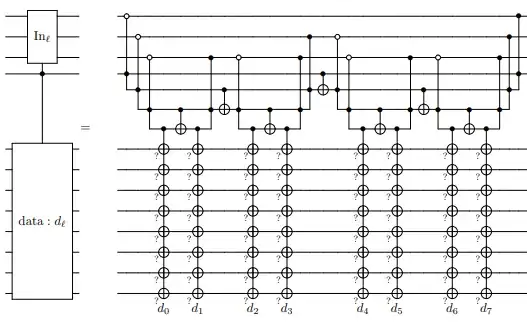

If $x$ is only 5 bits long, your best bet is almost definitely to just encode all the possible answers into a QROM circuit and do a lookup.
Here's a QROM circuit diagram from https://arxiv.org/abs/1805.036621:
And here's Q# source code for constructing a lookup circuit, from ancillary files of https://arxiv.org/abs/1905.076821.
