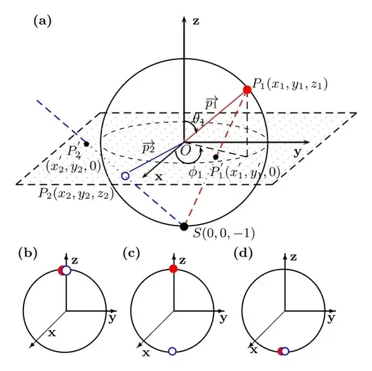

There are a number of efforts underway to provide a more general representation that extends from qubits to qudits. This explanation and representation using a Majorana sphere isn't so different, it's still a sphere, but perhaps it's less confusing:
For qubits on a Majorana sphere see: "N-qubit states as points on the Bloch sphere".
"Abstract. We show how the Majorana representation can be used to express the pure states of an N-qubit system ... In conclusion, the Majorana representation is useful when spin-$S$ particles are studied, while the alternative representation is preferable when the states of an $N$-qubit system are discussed. Besides helping to visualize $N$-qubit states and the way they transform in rotations and other operations, the latter representation may also help to identify some special $N$-qubit states, like the Majorana representation did in the context of spinor Bose-Einstein condensates.".
See: "Majorana representation, qutrit Hilbert space and NMR implementation of qutrit gates":
Page 1:
"The Bloch sphere provides a representation of the quantum states of a single qubit onto $\mathcal S^2$ (a unit sphere in three real dimensions), with pure states mapped onto the surface and the mixed states lying in the interior. This geometrical representation is useful in providing a visualization of quantum states and their transformations, particularly in the case of NMR-based quantum computation, where the spin-$\frac{1}{2}$ magnetization and its transformation through NMR rf pulses is visualized on the Bloch sphere. There have been several proposals for the geometrical representation for higher-level quantum systems however, extensions of a Bloch sphere-like picture to higher spins is not straightforward. A geometrical representation was proposed by Majorana in which, a pure state of a spin ‘$s$’ is represented by ‘2$_s$’ points on the surface of a unit sphere, called the Majorana sphere.
The Majorana representation for spin−$s$ systems has found widespread applications such as determining geometric phase of spins, representing $N$ spinors by $N$ points, geometrical representation of multi-qubit entangled states, statistics of chaotic quantum dynamical systems and characterizing polarized light. A single qutrit (three-level quantum system) is of particular importance in qudit-based ($d$-level quantum system) quantum computing schemes. A qutrit is the smallest system that exhibits inherent quantum features such as contextuality, which has been conjectured to be a resource for quantum computing. NMR qudit quantum computing can be performed by using nuclei with spin s > $\frac{1}{2}$ or can be modeled by two or more coupled spin-$\frac{1}{2}$ nuclei. In this work we use the Majorana sphere description of a single qutrit, where states of a qutrit are represented by a pair of points on a unit sphere, to provide insights into the qutrit state space.
Page 5:
The magnitude of the magnetization vector $\vert-$$\vec{M}$$\vert$ in a pure ensemble of a single qutrit can assume values in the range $[0,1]$. On the contrary, the pure ensemble of a qubit always possesses unit magnitude of the magnetization vector associated with it. The geometrical picture of the single qutrit magnetization vector is provided by the Majorana representation. The value $\vert-$$\vec{M}$$\vert$ depends upon the length of the bisector $OO'$ and lies along the $z$-axis and is rotationally invariant. Thus corresponding to a given value of the length of the bisector, one can assume concentric spheres with continuously varying radii, whose surfaces are the surfaces of constant magnetization. The radii of these spheres are equal to $\vert-$$\vec{M}$$\vert$, that vary in the range $[0,1]$.
Page 10:
CONCLUDING REMARKS
A geometrical representation of a qutrit is described in this work, wherein qutrit states are represented by two points on a unit sphere as per the Majorana representation. A parameterization of single-qutrit states was obtained to generate arbitrary states from a one-parameter family of canonical states via the action of $SO(3)$ transformations. The spin-$1$ magnetization vector was represented on the Majorana sphere and states were identified as ‘pointing’ or ‘non-pointing’ depending on the zero or non-zero value of the spin magnetization. The transformations generated by the action of $SU(3)$ generators were also integrated into the Majorana geometrical picture. Unlike qubits, the decomposition of single-qutrit quantum gates in terms of radio-frequency pulses is not straightforward and the Majorana sphere representation provides a way to geometrically describe these gates. Close observations of the dynamics of points representing a qutrit on the Majorana sphere under the action of various quantum gates were used to obtain the rf pulse decompositions and basic single-qutrit gates were experimentally implemented using NMR.
Majorana Sphere - Dogra, Dorai, and Arvind
FIG. 1. A qutrit on the Majorana sphere is represented by two points $P_1$ and $P_2$, connected with the center of the sphere by lines shown in red and blue respectively. $\theta_1$, $\phi_1$ are the polar and azimuthal angles corresponding to point $P_1$ ($\theta_2$, $\phi_2$ are the angles for point $P_2$). (a) Roots of the Majorana polynomial are shown in the plane $z = 0$ by points $P'_1$ and $P'_2$, whose stereographic projection give rise to the Majorana representation. Three examples are shown corresponding to the Majorana representation of single-qutrit basis vectors $(b)\;\vert+1\rangle$, $(c)\;\vert0\rangle$ and $(d)\;\vert-1\rangle$. One of the points is shown as a solid (red) circle, while the other point is represented by an empty (blue) circle.
