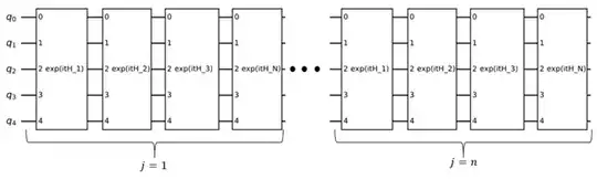

If you have a Hermitian matrix, Hamiltonian, of the form $H = \sum_i H_i$. Then we can approximate $e^{-iHt}$ as follows:
$$ e^{-iHt} \approx \prod_{j=1}^n \prod_i e^{-iH_i t/n} $$
This approximation is a consequence of the Trotter product or also known as Lie product formula.
Now in term quantum circuit, it will be something like:
Then you somehow need to decompose each of the operator $e^{itH_i}$ into elementary gates. To do this step, look at this paper here: Simulation of Electronic Structure Hamiltonians UsingQuantum Computers. This answer by Davit is also really good reference to look at.
